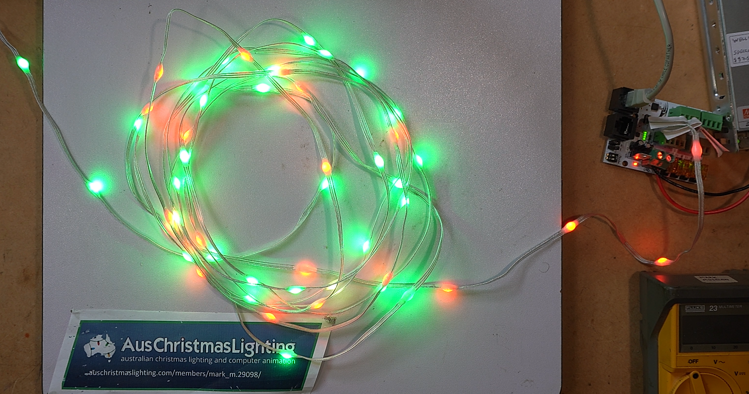

Those 'soft wire' seed pixels seem to be rigid enough for outdoors. I have been working on a large prop with 2,400 of these.
Current of my version (from GFLAI lighting) is about 34mA per node at 100% white.
In this graph I measured the current draw of a string of 50, 10 and 1 node, then divided to work out the current per node.
Obviously the longer string of 50 used less current per node because of the wire resistance.
*Test string was powered from one end (no power injection).
From my testing, I found power injecting every 50 nodes should be fine.
Without power injection, node ~70 onwards goes noticeably off-white.
*injecting* every 50? Or injecting every 100 so that no node is more than 50 from a power source?
Mark_M
Annoying Elf
Dec 30, 2018
925
Christmas Light world
ah, right.
50 would be powered from one end.
Theoretically you could do every 100 then.
Now to add confusion lol, my current project with these pixels is a string of 80 and powered from both ends. The middle nodes look slightly yellow when set to 100% white.
Weird huh? That's 40 pixels from each power source, yet 50th node powered from one end at 100% white looks fine??
My best guess is the connector I soldered on has significant voltage drop given it's small wire gauge (oops).
